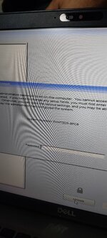

Selam ,
Dell laptop ile ilgili Sifre sorunu yasiyorum.
Laptopun ana kartindan ve modelinden sizlere resim atiyorum.
Bios chipini degistirmeme ragmen Bios Pass silemedim.
Yardiminiza ihtiyacim var.

Here you go.
FVNT3D3-8FC8
need bios backup to unlock it
there is no other way

There is a bios password again.
I read on some sites that the bios password is not stored in the bios chip in this model of laptop.
But it doesn't show where it is hidden and on which chip it is hidden, could this be true?
